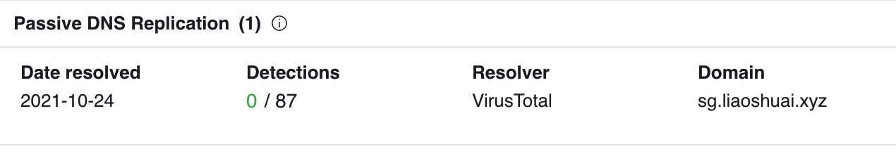

Hi, Interesting read, thanks for sharing Dessalegn, FYI: IP Address mentioned in Codebgp's report 194.156.163.203 (Singapore/Misaka Network) was hosting a .xyz domain (see below passive DNS from virustotal). [image: image.png] Kind Regards *Hafiz Farooq* --- This message has been scanned via Symantec MessageLabs & SpamDefense Engine On Fri, May 5, 2023 at 3:08 PM Terry Manderson <terry@terrym.net> wrote:
