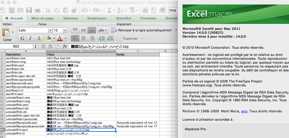

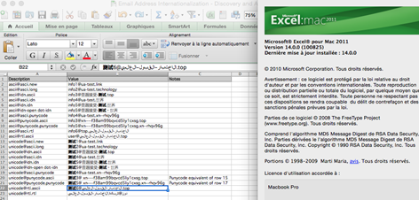

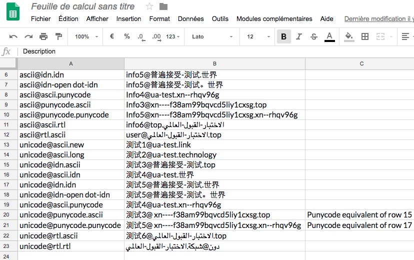

Hi Evan Test case are displayed correctly with google sheet [image: image.png] But with I still have the same display issues with MS Excel (2011) on mac os 10.10.5 [image: image.png] Please note Arabic test cases mixing RTL and LTR label/codePoint (line 11, 12 and 22) are confusable for the Arabic user How to distinguish between Mailbox and domain parts ? this depends on reading from left to right or right to left. On may,09 2018 we had a good discussionIn in the UA-Discuss mailing list about RTL and LTR issues with Arabic scripts. Best regards Le mer. 8 août 2018 à 04:55, Evan Hanson <evanh@catalyst.net.nz> a écrit :

This is a really old version of Office. Have you tried using the latest? Which macOS version are you running? Paul
8 авг. 2018 г., в 6:29 ДП, Zied BOUZIRI <zied.bouziri@gmail.com> написал(а):
Hi Evan Test case are displayed correctly with google sheet <image.png>
But with I still have the same display issues with MS Excel (2011) on mac os 10.10.5 <image.png>

Hi Looking at the spreadsheet, Email use case sheet :
Arabic uses cases are not displayed correctly, for example :
the correct form is info6@test.الاختبار-القبول-العالمي
other wrong use cases :
Best regards
