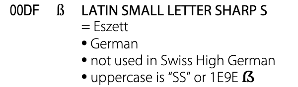

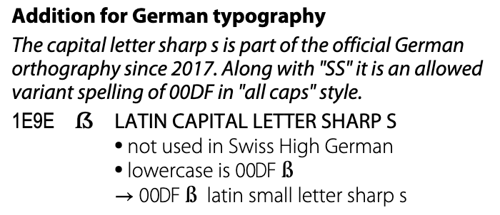

There is, in fact, a upper case version too, U+1E9E LATIN CAPITAL LETTER SHARP S. There is, however, asymmetrical formal case relationship between them, probably since the upper case letter was added later. If you go to https://www.unicode.org/charts/PDF/U0080.pdf, page 4, and look at the 00DF entry it says [cid:image001.png@01D78520.AEE9E210] Also see https://codepoints.net/U+1E9E and https://www.unicode.org/charts/PDF/U1E00.pdf, page 6: [cid:image002.png@01D78520.AEE9E210] Mats -- --- Mats Dufberg mats.dufberg@internetstiftelsen.se Technical Expert Internetstiftelsen (The Swedish Internet Foundation) Mobile: +46 73 065 3899 https://internetstiftelsen.se/ From: Hazem Hezzah <hhezzah.las@gmail.com> Date: Friday, 30 July 2021 at 00:38 To: Mats Dufberg <mats.dufberg@internetstiftelsen.se>, ICANN Latin GP <latingp@icann.org> Subject: RE: [Latingp] U+00DF LATIN SMALL LETTER SHARP S Seems that I made this confusion by suggesting to name it “Sharp S” only. As far as I know there is no Capital Sharp S. In the Unicode Standard that Mats sent there is no Capital Sharp S mentioned. In the other document it is called “Small Letter Sharp S”, but in the rest of the document only “Sharp S” Let’s hear Meikal and Michael’s opinion. Reagrds, Hazem Hezzah From: Mats Dufberg via Latingp<mailto:latingp@icann.org> Sent: 29 July 2021 23:41 To: ICANN Latin GP<mailto:latingp@icann.org> Subject: Re: [Latingp] U+00DF LATIN SMALL LETTER SHARP S In the main document nothing needs to be updated. In the appendix D.5 some instances needs to be corrected. I have in those cases added "Small" a proposed edit. -- --- Mats Dufberg mats.dufberg@internetstiftelsen.se Technical Expert Internetstiftelsen (The Swedish Internet Foundation) Mobile: +46 73 065 3899 https://internetstiftelsen.se/ From: Latingp <latingp-bounces@icann.org> on behalf of ICANN Latin GP <latingp@icann.org> Reply to: Mats Dufberg <mats.dufberg@internetstiftelsen.se> Date: Thursday, 29 July 2021 at 22:20 To: Bill Jouris <bill.jouris@insidethestack.com>, ICANN Latin GP <latingp@icann.org> Subject: Re: [Latingp] U+00DF LATIN SMALL LETTER SHARP S I searched through the main document. Either it is referred to as "Latin Small Letter Sharp S" (10 times, 1 time in upper case) or "Sharp S" (14 times). I cannot find any "Latin Letter Sharp S". In appendix D.5 all three variants are used. There we should replace "Latin Letter Sharp S" with "Latin Small Letter Sharp S" to be consistent. In running text where the name is used several times it should be OK with the shorter "Sharp S". Mats -- --- Mats Dufberg mats.dufberg@internetstiftelsen.se Technical Expert Internetstiftelsen (The Swedish Internet Foundation) Mobile: +46 73 065 3899 https://internetstiftelsen.se/ From: Bill Jouris <bill.jouris@insidethestack.com> Reply to: Bill Jouris <bill.jouris@insidethestack.com> Date: Thursday, 29 July 2021 at 19:09 To: ICANN Latin GP <latingp@icann.org>, Mats Dufberg <mats.dufberg@internetstiftelsen.se> Subject: Re: [Latingp] U+00DF LATIN SMALL LETTER SHARP S If so, we will need to go thru the whole document and change it. Because I believe we generally used just "Latin Letter Sharp S". But perhaps the German speakers can comment on how the Sharp S is viewed by those who actually use it. Bill Jouris Inside Products bill.jouris@insidethestack.com 831-659-8360 925-855-9512 (direct) On Thursday, July 29, 2021, 10:05:30 AM PDT, Mats Dufberg via Latingp <latingp@icann.org> wrote: I think it should be LATIN SMALL LETTER SHARP S. See https://codepoints.net/U+00DF and https://www.unicode.org/charts/PDF/U0080.pdf (page 4) Mats -- --- Mats Dufberg mats.dufberg@internetstiftelsen.se Technical Expert Internetstiftelsen (The Swedish Internet Foundation) Mobile: +46 73 065 3899 https://internetstiftelsen.se/ _______________________________________________ Latingp mailing list Latingp@icann.org<mailto:Latingp@icann.org> https://mm.icann.org/mailman/listinfo/latingp _______________________________________________ By submitting your personal data, you consent to the processing of your personal data for purposes of subscribing to this mailing list accordance with the ICANN Privacy Policy (https://www.icann.org/privacy/policy) and the website Terms of Service (https://www.icann.org/privacy/tos). You can visit the Mailman link above to change your membership status or configuration, including unsubscribing, setting digest-style delivery or disabling delivery altogether (e.g., for a vacation), and so on.
