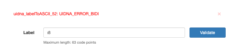

Good morning …. I reviewed the latest HTML XML-output (22 Apr); here is some feedback for your consideration. 1. Repertoire. I did a quick summary of the repertoire and found 219 elements. The comment section at the top of the HTML document refers to 218. 2. Variant Disposition. It is not clear what this paragraph is trying to say (at least I don’t understand it fully). It seems it is trying to explain what policy might recommend. If so, then it may be best idea to leave it out. 3. Suggest editing “Overlapped sequence: one sequence with a variant "ss" is overlapped with a code point "s" that has a variant of its own. To ensure that the sets of variant labels are well-behaved, additional variant mappings, including an out-of-repertoire sequence had to be defined: U+0455 U+0455, among others.” 4. Not specific to the LGR, but feedback for the LGR Tool. Spotted error while testing label ‘ıß’ (0131 00df). Error also happens with sequence 00df 0131. See screenshot below. Hope this is helpful. Best, Dennis PS. I have a schedule conflict and won’t be able to attend. [cid:image001.png@01D73760.F1AD8D30] From: Latingp <latingp-bounces@icann.org> on behalf of Mirjana Tasić via Latingp <latingp@icann.org> Reply-To: Mirjana Tasić <Mirjana.Tasic@rnids.rs> Date: Tuesday, April 20, 2021 at 4:48 PM To: Latin GP <latingp@icann.org> Subject: [EXTERNAL] [Latingp] Agenda for Latin GP call on April the 22nd, 2021 Caution: This email originated from outside the organization. Do not click links or open attachments unless you recognize the sender and know the content is safe. Dear GP members, Please find enclosed the Agenda proposal for our next call. Any comments and suggestions are welcome. Pitinan finalized the clean version of the Report. All materials could be found at https://onedrive.live.com/?id=48AA6AACD70E3A81%211101&cid=48AA6AACD70E3A81 In order to access the documents someone should sign in with Microsoft account. Regards Mirjana Agenda for Latin GP call on April the 22nd, 2021 1. Finalize the Latin GP Report V6 · confirm all edits to the main Report · confirm the XML 2. Status of test data set 3. AOB
