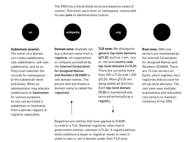

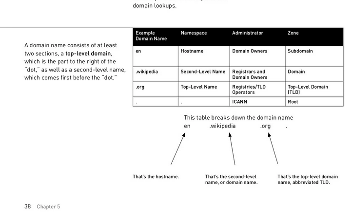

* Slide 6: There are better schematics to describe this. Sorry to toot my own horn, but in my book we use the attached graphic.
Both graphics describe subdomains under a registered domain (like en.wikipedia.org) as the "subdomain zone", which is not a correct use of the technical term. (Zones are things that have NS records; the name mentioned doesn't have any.)
